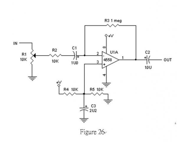

Since bi-polar power suppliesaren't always available, you can operate this same circuit from a single endedpower supply. All that is necessary is that the -V pin is tied to ground andthe + input is "biased" to half the power supply voltage. Of courseyou must realize that in order to keep the same headroom, you will have todouble the positive supply. In most cases this isn't necessary especially ifworking with small signals. Also the two capacitors, C1 and C2, must be presentin order to keep the opamp stable and operating in its linear region. Figure 26shows how to connect the same circuit with a single power supply.

Figure 26
You can bias the + input bybuilding a voltage divider, filtering it, and applying the 1/2 voltage to the +input. C3 is not a critical value. Neither is R4 and R5. They can be as high as100K
Hint: When troubleshooting thiscircuit, both inputs and the output will be idling at 1/2 the power supplyvoltage with no signal present. Any voltage other than 1/2 the supply means thecircuit is not wired properly or the opamp is defective. Example. If you areusing a 12 volt supply, the DC voltage on pins 1, 2, and 3 must be 6 volts.
Frequency response - the usablebandwidth of the circuit. This is usually the 3db point. An example is inFigure 26, R2 and C1. The impedance is 10K ohms and the capacitance is 1uf.Using the formula f=1/(2Pi*(R*C)), the usable low frequency is down to16 HZ.
